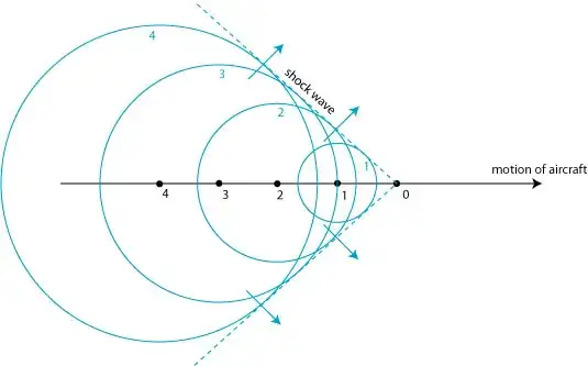

It's explained in the case of an aircraft travelling at supersonic speed with an image that is similar to this:
Now from what I've understood, each circle represents the crest of a longitudal wave. Now I understand that anyone standing in the 'cone' will simply receive the circle crests and undergo the Doppler effect. But what I don't understand is how the two lines (or the cone if you want to go 3-dimensional) are a wave. It is explained as there being constructive interference of the blue waves there, but I don't see any point on the shock wave lines where the circle crests overlap? What kind of wave is this shock wave, longitudal? Does it propagate, in which direction? I am failing to understand what a shock wave 'looks like.'

The circles in that image are really just meant to be a visualization tool. In some contexts, one may use circles to illustrate sound waves (or other types of waves) being emitted by a moving source (e.g., some Doppler effect illustrations use this).
Yes, a shock wave is a longitudinal wave, specifically a nonlinearly steepened sound wave that has reached a balance between steepening and energy dissipation. The resulting phenomena has one "crest," to use your term, and no oscillations. It is a discontinuous transition between the upstream(unshocked) and downstream(shocked) regions.

Yes, shock waves propagate. In your picture example, the shock would propagate parallel to arrows (i.e., orthogonal to the cone). A sonic boom associated with shock waves in Earth's atmosphere is the pressure pulse of the shock itself.
