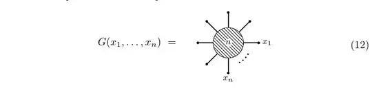

tikz code: https://pastebin.com/ciYjYwAF
and the $n$-point function is represented as a disk with $n$ lines:
tikz code: https://pastebin.com/E4Wg1y8X

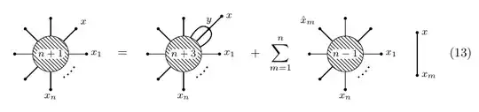

In graphical terms, one typically represents the SD equations $(10)$ as follows:
tikz code: https://pastebin.com/Z49jqAei

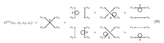

We can use the same technique to compute the first order correction to the four-point function. The reasoning is the same as before; equation $(17)$ reads \begin{equation} \begin{aligned} G^{(1)}(x_1,x_2,x_3,x_4)&=\frac{1}{3!}\int\Delta(x-y)G^{(0)}(y,y,y,x_2,x_3,x_4)\,\mathrm dy\\ &+i\Delta(x_1-x_2)G^{(1)}(x_3,x_4)\\ &+i\Delta(x_1-x_3)G^{(1)}(x_2,x_4)\\ &+i\Delta(x_1-x_4)G^{(1)}(x_2,x_3) \end{aligned}\tag{26} \end{equation}
From our previous calculation, we already know the value of $G^{(1)}(x_1,x_2)$; on the other hand, the term $G^{(0)}(y,y,y,x_2,x_3,x_4)$ can be efficiently computed using Wick's theorem; in particular, \begin{equation} \begin{aligned} iG^{(0)}(y,y,y,x_2,x_3,x_4)=\,&3\Delta(y-y)\Delta(y-x_2)\Delta(x_3-x_4)\\ +&3\Delta(y-y)\Delta(y-x_3)\Delta(x_2-x_4)\\ +&3\Delta(y-y)\Delta(y-x_4)\Delta(x_2-x_3)\\ +&6\Delta(y-x_2)\Delta(y-x_3)\Delta(y-x_4) \end{aligned}\tag{27} \end{equation} so that \begin{equation} \begin{aligned} -G^{(1)}(x_1,x_2,x_3,x_4)&=\frac12\Delta(x_1-x_2)\int\Delta(x_3-y)\Delta(y-y)\Delta(x_4-y)\,\mathrm dy\\ &+\frac12\Delta(x_1-x_3)\int\Delta(x_2-y)\Delta(y-y)\Delta(x_4-y)\,\mathrm dy\\ &+\frac12\Delta(x_1-x_4)\int\Delta(x_2-y)\Delta(y-y)\Delta(x_3-y)\,\mathrm dy\\ &+\frac{1}{2}\Delta(x_3-x_4)\int\Delta(x_1-y)\Delta(y-y)\Delta(y-x_2)\,\mathrm dy\\ &+\frac{1}{2}\Delta(x_2-x_4)\int\Delta(x_1-y)\Delta(y-y)\Delta(y-x_3)\,\mathrm dy\\ &+\frac{1}{2}\Delta(x_2-x_3)\int\Delta(x_1-y)\Delta(y-y)\Delta(y-x_4)\,\mathrm dy\\ &+\int\Delta(x_1-y)\Delta(y-x_2)\Delta(y-x_3)\Delta(y-x_4)\,\mathrm dy \end{aligned}\tag{28} \end{equation} which, as expected, agrees with the value of the one-loop diagrams:
tikz code: https://pastebin.com/c04ZrGqW

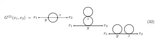

As a final example, let us compute the second order correction to $G(x_1,x_2)$, to wit, \begin{equation}\tag{30} G^{(2)}(x_1,x_2)=\frac{1}{3!}\int\Delta(x_1-y)G^{(1)}(y,y,y,x_2)\,\mathrm dy \end{equation} where $G^{(1)}(y,y,y,x_2)$ is given by $(26)$. The final result is \begin{equation} \begin{aligned} G^{(2)}(x_1,x_2)&=\frac{1}{3!}\int\Delta(x_1-y)\Delta(y-z)\Delta(z-y)\Delta(z-y)\Delta(z-x_2)\,\mathrm dy\,\mathrm dz\\ &+\frac{1}{3}\int\Delta(x_1-y)\Delta(y-y)\Delta(y-z)\Delta(z-z)\Delta(z-z)\,\mathrm dy\,\mathrm dz\\ &+\frac{1}{3}\int\Delta(x_1-y)\Delta(y-z)\Delta(z-z)\Delta(z-y)\Delta(y-z)\,\mathrm dy\,\mathrm dz \end{aligned}\tag{31} \end{equation} which, once again, agrees with the value of the diagrams
tikz code: https://pastebin.com/1nXqq4Sg

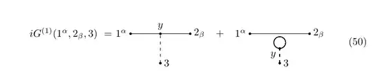

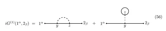

Finally, the fermionic two-point function $G(1^\alpha,2_\beta)$ satisfies \begin{equation}\tag{53} i G(1^\alpha,2_\beta)=ig\int S_{1y}^\alpha{}_\gamma G(y,y^\gamma,2_\beta)\mathrm dy+iS^\alpha_{12\beta} \end{equation} which, to order zero in $g$, becomes $G^{(0)}(1^\alpha,2_\beta)=S^\alpha_{12\beta}$, as expected. The first correction is \begin{equation}\tag{54} iG^{(1)}(1^\alpha,2_\beta)=i\int S_{1y}^\alpha{}_\gamma G^{(0)}(y,y^\gamma,2_\beta)\mathrm dy=0 \end{equation} since $G^{(0)}(y,y^\gamma,2_\beta)=0$.
To second order in $g$, \begin{equation} \begin{aligned} i G^{(2)}(1^\alpha,2_\beta)&=i\int S_{1y}^\alpha{}_\gamma G^{(1)}(y,y^\gamma,2_\beta)\mathrm dy=\\ &=-\int \Delta_{yz} (S_{1y}S_{yz}S_{z2})^\alpha{}_\beta-(S_{1y}S_{y2})^\alpha{}_\beta\Delta_{yz}\text{tr}(S_{zz})\mathrm dy\,\mathrm dz \end{aligned}\tag{55} \end{equation} which, as one would expect, agrees with the one-loop Feynman diagram
tikz code: https://pastebin.com/ChMUk1sx
