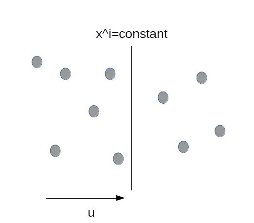

I will not address the meaning of this definition since a descent explanation is given here. I will however, demonstrate how we can relate the space-space component of $T^{\mu \nu}$ to $\sigma^{ij}$. We consider a surface of constant $x^i$ (assumed to increase to the right) as shown in the figure below and take the case of a stream of particles density $n$ all moving at the same constant velocity $u$.
The momentum flux through this surface is going to be: $$T^{ii}=mnu^2$$ However the the force per unit area acting on the right hand side surface (that with normal in the direction of increasing $x^i$) is given by: $$\sigma^{ii}=-mnu^2$$. Analogous arguments hold for other components giving us: $$(T^{\mu \nu})_{ss}=-\sigma^{ij}$$ This explains the sign error in my question above.
