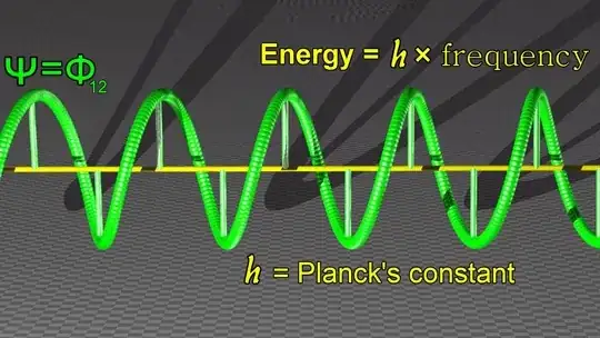

Once measuring momentum, the wavefunction "collapses" into something that looks like this
If you were to then measure the position, couldn't it be literally anywhere? What am I missing? Is it even possible to measure momentum perfectly?

We call a wavefunction that has a precisely defined momentum a momentum eigenstate. For a free particle the momentum eigenstates are infinite plane waves like the one you show in your graph:
$$ \psi = e^{i(\mathbf p\cdot\mathbf x - \omega t)} $$
And as you say in your question for this eigenstate the position of the particle is completely undefined, or put another way $\Delta x = \infty$.

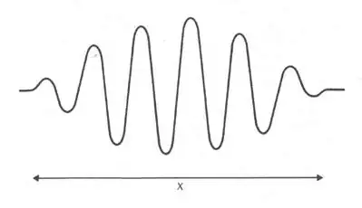

But how are you ever going to make a measurement that results in an infinite plane wave? What possible physical process could achieve this? Any measurement necessarily takes place within some finite region so the best you can achieve is to end up with a wavepacket that is about the size of your system:
Wave packet
where $x$ is some length scale determined by how you did the measurement. The resulting wavefunction will be:
$$ \psi = \mathcal F(\mathbf x,t) e^{i(\mathbf p\cdot\mathbf x - \omega t)} $$
where $\mathcal F(\mathbf x,t)$ is the envelope function. However this wavepacket no longer has a precisely defined momentum because it is not an infinite plane wave so it isn't a momentum eigenstate. In fact the momentum spread will be roughly given by:
$$ \Delta p = \frac{\hbar}{2x} $$
i.e. just the uncertainty principle. So as a consequence of your measuring apparatus having a limited extent in space you can only measure the momentum to a limited precision. Your measurement does not cause the wavefunction to collapse to a momentum eigenfunction and the resulting particle cannot be anywhere in space.
