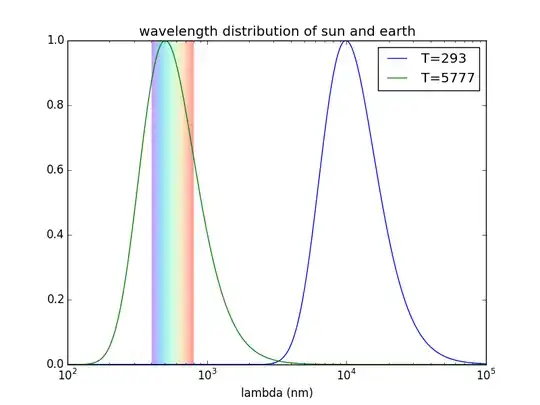

  3. Because Earth is much cooler than the sun, the spectrum of radiation of the surface is shifted towards the IR part of the spectrum. Here is a plot of the spectrum of the Sun and Earth (assumed at 20 °C), with their peaks normalized for easy comparison, and with the visible light range overlaid:

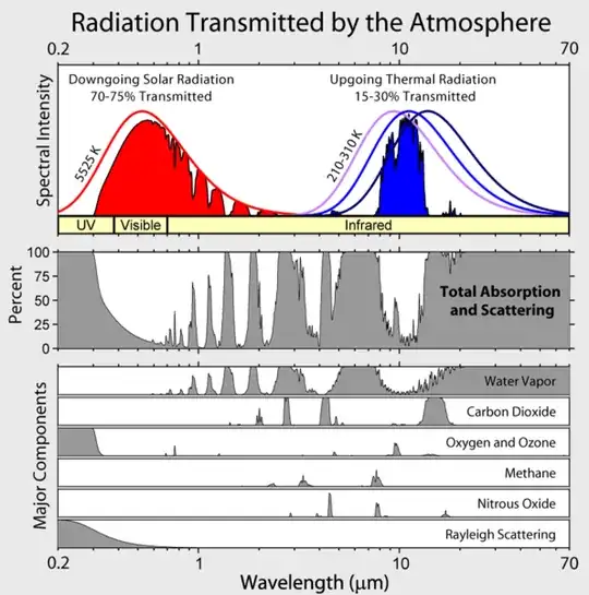

The second effect is absorption. The absorption spectrum of $\rm{CO_2}$ can be found for example at Clive Best's blog
As you can see, much of the energy emitted by Earth is absorbed by the atmosphere: $\rm{CO_2}$ is not the only culprit, but it does have an absorption peak that is quite close to the peak emission of Earth's surface, so it plays a role. Increase the $\rm{CO_2}$ and you increase the amount of energy that is captured by the atmosphere. Now when that energy is re-emitted, roughly half of it will be emittend towards the Earth, and the other half will be emitted to space.
As energy is re-emitted back to Earth, the effective mean temperature that the surface has to reach before there is equilibrium (given a constant influx of energy from the Sun) goes up.
There are many complicating factors. Hotter surface may mean more clouds and thus more reflected sunlight; on the other hand, increased water vapor also implies increased absorption in the IR.
But the basic idea that absorption of IR by the atmosphere will lead to an increased equilibrium temperature of the surface should be pretty clear.

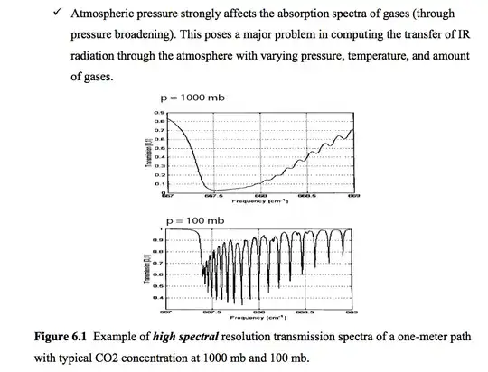

Spectral broadening
First - there is the issue of spectral broadening. According to [this lecture](http://irina.eas.gatech.edu/EAS8803_Fall2009/Lec6.pdf) and references therein, there is significant pressure broadening of the absorption lines in $\rm{CO_2}$. Pressure broadening is the result of frequent collisions between molecules - if the time between collisions is short compared to the lifetime of the decay (which sets a lower limit on the peak width), then the absorption peak becomes broader. The link gives an example of this for $\rm{CO_2}$ at 1000 mb (sea level) and 100 mb (about 10 km above sea level):
This tells me that as the concentration of $\rm{CO_2}$ in the atmopshere increases, there will be more of it in the lower (high pressure) layers, where it effectively has no "windows". At lower pressures, the gaps between the absorption peaks would let more of the energy escape without interaction. This will be more important in the upper atmosphere - not so much near Earth's surface where pressure broadening is significant.
