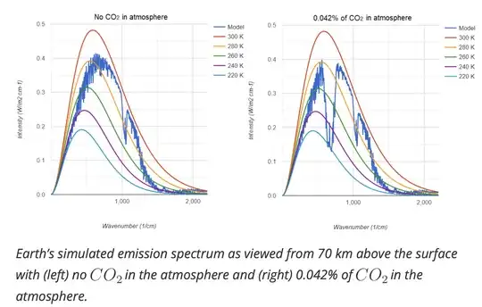

The answers here are all highly speculative and are all also missing a crucial point about the Greenhouse Effect: when considering the greenhouse effect, we are more concerned with relatively low-frequency absorption bands than high-frequency absorption bands. To see why, compare the following two blackbody emission spectra taken from this post that show the simulated emission spectrum of the Earth with and without the 0.04% CO$_2$ contribution in the atmosphere.
Greenhouse

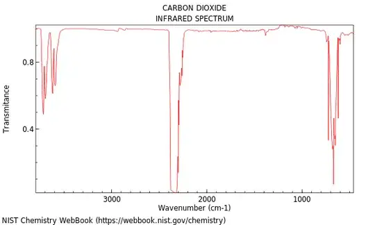

This is a pretty striking difference! The difference comes from the strong absorption band in the CO$_2$ spectrum around 600 cm$^{-1}$, as shown in its IR spectrum,
CO2

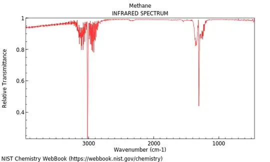

Also notice that, with or without greenhouse gases, there is little emission corresponding to higher-frequency radiation since our atmosphere already has a significant amount of gases that absorb in those regions. But methane also has a strong absorption band in its IR spectrum relatively near the region of maximal emission from Earth, as shown in the following,
Methane
Worse yet, this band does not directly overlap with the most intense part of either the bands for H$_2$O (shown below) or CO$_2$, which means that it can also contribute to the Greenhouse Effect. It should be emphasized that methane is an extremely trace gas, however, and that given the growing preponderance of CO$_2$ we should really be more concerned about its obvious effects on our climate.
