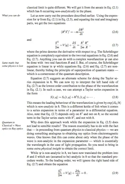

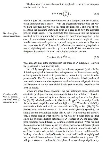

I am reading a book called Sleeping Beauties in Theoretical Physics. In chapter 2 of this book the writer is trying to describe the emergence of classical mechanics from quantum mechanics. I have seen the emergence of classical mechanics from quantum mechanics before from Path Integral. Moreover, I have read this post also. However, I am having problem following this logic. I do not understand his approach (specially the taylor expansion in equation 2.2 and equation 2.8) Addendum: I do know that he is trying to get to Hamilton-Jacobi Equation (2.9) (via Eikonal approximation)

  1. Perhaps OP would be more satisfied if we first changed the variable $$\Psi~=~e^{\Phi}\tag{1}$$ in the TDSE so that it becomes a non-linear Riccati equation $$ i\hbar \dot{\Phi}~=~-\frac{\hbar^2}{2m} (\Phi^{\prime\prime}+\Phi^{\prime2}) + V. \tag{2}$$
  2. Now claim that $\Phi$ is a truncated formal Laurent series of the form $$ \Phi~=~\sum_{n=N}^{\infty} \Phi_n \hbar^n , \qquad N\in\ \mathbb{Z}.\tag{3}$$ It is truncated at the term $n=N$ because we expert a correspondence with classical physics. Also note that formal multiplication of truncated Laurent series is well-defined and makes sense. Hence the Riccati eq. (2) becomes an infinite tower of equations.
  3. Next adjust $N=-1$ and rename $\Phi_{-1}=iS_0$, so that the leading equation in eq. (2) is the Hamilton-Jacobi/Eikonal equation.
  4. Finally rename $$\Phi~=~\frac{i}{\hbar} S + \ln R, \tag{4}$$ where $S$ and $R$ are Taylor series in $\hbar$. The variable $\Phi$ may be viewed as an asymptotic expansion in $\hbar$.
