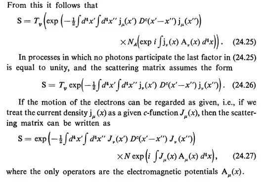

Physically the energy spent to create photons is much smaller than the transferred energy in collisions of charged particles. In the zeroth-order approximation one can neglect the influence of the lost energy on the particle scattering and then the particle behavior becomes known at all times. Often it is referred as to a "classical current" $j(t)$. On the other hand, the radiation equation in this approximation is, roughly speaking, linear in the known current $j$: $\square A =j$ and so are the corresponding Fourier components. To be exact, one has to solve the QED equations in this approximation, see formula (24.27) in Akhiezer-Berestetski textbook:
S-martix as a sum of normal products
In this approximation the field solution for each harmonics is an eigenstate of the lowering operator $a_{\omega}$. It simply means two things: 1) emitted photons do not hinder/favorise each other while emitting, and 2) there is always enough energy to create any number of photons. In other words, emission of one photon does not influence emission of another one at the same or any other time. Their emission is random. Now statistics of randomly emitted number of photons comes into play and you get the Poisson distribution.
As soon as you fix or limit from above the emitted energy, the Poisson distribution gets spoiled, especially for high frequencies and high photon numbers.
