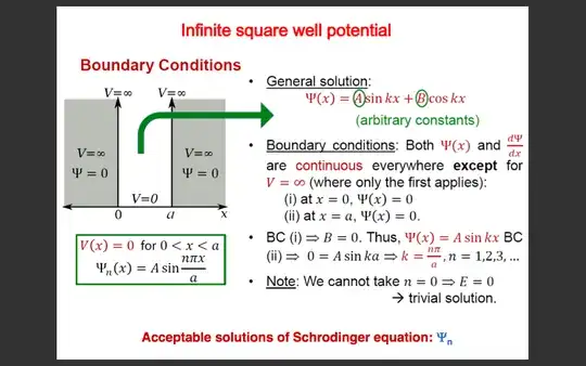

According to the Born's postulates, psi should be atleast differentiable to the first order then why does we not require psi in this case to be differentiable at X = a and X = 0. According to the Born's postulates, psi should be atleast differentiable to the first order then why does we not require psi in this case to be differentiable at X = a and X = 0.Also psi comes out to be a sinosoid and hence the probability density of the particle varies along the x axis and hence the velocity. But why is this so, classically it should be going under to and fro motion with the constant speed. I am novice in this field. Please help me with this.

You've identified the main one: we ignore the usual requirement that $\frac{\mathrm{d}}{\mathrm{d}x}\psi(x)$ be continuous at the boundaries.

Consider what the solution would be like if the well was deep (many time the ground-state energy), but finite: it had a maximum of $V_0 \gg E$. In that case the wave-function would not be zero outside the well it would take on the form $$ \psi_{ex} = C e^{\pm i \kappa x} \;,$$ where 'ex' indicates exterior, $\kappa = \sqrt{2m(V_0 - E)}/\hbar$, and $C$ is a constant.
Because the wave-function must be normalizable we could only use the $+$ term on the left side and the $-$ term on the right side.
Then we impose the usual continuity condition including continuity of the derivative, and we would get a smooth curve connecting the sinusoidal term in the well asymptoptically with the horizontal axis.
Now allow $V_0$ to grow. The connecting terms will approach the axis ever more closely over an ever shorter range in $x$. As $V_0$ gets to be very large indeed this will more and more closely approach a discontinuous change in slope (at least if we step back and take out glasses off). In the limit as $V_0$ grows without bound the slope becomes discontinuous at the edge of the well.
So this violation of the usual rules is justifiable as long as you take seriously the notion go infinite potential steps. But the argument that this is so is clearer if you have already done a couple of more involved problems before you are given the argument in the first place. So the justification is often skipped on the first pass over the infinite square well problem.
