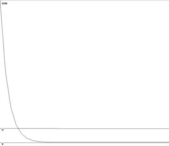

The mistake here is a confusion between the total energy contained, and the rate at which energy is currently being released.
As we all know, radioactive materials have half lives. That's the length of time necessary for approximately half of a mass to decay. That leads to a curve that asymptotically approaches 0.
[Note: the curves aren't really scaled well to each other--to scale them properly, if I drew the Strontium curve to fit on a typical screen, the Uranium curve would still be less than one pixel away from the 0 line at the bottom.]
So, the total energy that can be released by radioactive decay for some material corresponds to the area under the curve for that material. The current level of radioactivity corresponds to the current height of the curve.
Here I've drawn a (semi-accurate) curve for Strontium 90. Each horizontal pixel (as I originally drew it--it's been scaled down a bit here) corresponds roughly to one year. So, the Strontium 90 starts at a very high level of radioactivity. But it's decaying quite rapidly; within a few hundred years the vast majority of it has decayed, so it no longer contains much potential energy. Toward the left side of the curve, the curve is very high, but it drops rapidly, and the total area under the curve is fairly small, signifying a relatively small total quantity of energy.
The lower curve labeled "U" is a (less accurate) curve for Uranium. It sits a lot lower, reflecting the fact that much less energy is being released at the beginning--but the area under the curve is much greater, because it drops so much more slowly.
So, when material is used as fuel in a reactor, it's absolutely true that energy has been released, so the waste is materials with less area under the curves. Nonetheless, much of the waste is material like Strontium 90 at the far left side of the graph, with a high level of radioactive emissions.
