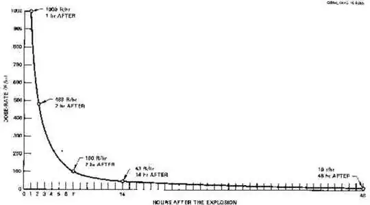

The relevant Wikipedia page gives as a source for this rule a 1987 book by Cresson Kearny on surviving nuclear war. The seven-ten rule (not so named in the text) is described in the first chapter:
Fortunately for all living things, the danger from fallout radiation lessens with time. The radioactive decay, as this lessening is called, is rapid at first, then gets slower and slower. The dose rate (the amount of radiation received per hour) decreases accordingly. Figure 1.2 illustrates the rapidity of the decay of radiation from fallout during the first two days after the nuclear explosion that produced it. R stands for roentgen, a measurement unit often used to measure exposure to gamma rays and X rays. Fallout meters called dosimeters measure the dose received by recording the number of R. Fallout meters called survey meters, or dose-rate meters, measure the dose rate by recording the number of R being received per hour at the time of measurement. Notice that it takes about seven times as long for the dose rate to decay from 1000 roentgens per hour (1000 R/hr) to 10 R/hr (48 hours) as to decay from 1000 R/hr to 100 R/hr (7 hours). (Only in high-fallout areas would the dose rate 1 hour after the explosion be as high as 1000 roentgens per hour.)
figure 1.2
Fig. 1.2. Decay of the dose rate of radiation from fallout, from the time of the explosion, not from the time of fallout deposition. ORNL.DWG 78-265
If the dose rate 1 hour after an explosion is 1000 R/hr, it would take about 2 weeks for the dose rate to be reduced to 1 R/hr solely as a result of radioactive decay. Weathering effects will reduce the dose rate further,' for example, rain can wash fallout particles from plants and houses to lower positions on or closer to the ground. Surrounding objects would reduce the radiation dose from these low-lying particles.
This is not an exponential decay. If you're looking at a single isotope whose activity falls by a factor of ten in seven days, it'll fall by another factor of ten in the next seven days --- waiting until day 49 is not required.
What happens in uranium fission is that you get a melange of different isotopes. The largest amount of activity comes from the shortest-lived among them. However after a brief time, those short-lived isotopes are all gone, and the radiation is coming from the longer-lived isotopes. The exact shape of the curve would depend on the exact mix of isotopes produced. Kearny's book has a selected bibliography, but it's not obvious what part of that bibliography is the source of the isotope mix that gives rise to the seven-ten rule. It's possible that the rule is (or was in the 1980s) entirely empirical, based on the radiation profile of nuclear waste.

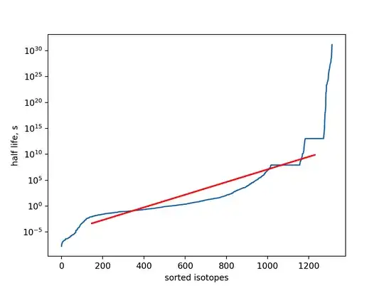

As long as isotopes half-lifes are log-uniformly spread, decay of their mix will follow hyperbolic law. Actually we do not even need really good uniformity - even big random error will not break hyperbola. See my code
I suppose it is connected to the distribution of half-lives, but I have no idea how to explain in a good way why fallout mix is relatively log-uniform.
nndc.bnl.gov data
