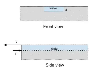

Response to Olly's comment: to do this with any degree of accuracy you need to reach for your finite element software and numerically solve the Navier-Stokes equations. But let's have a go using a very simplified model. NB I'm making this up as I go along, so you should probably check it before sending it to the Nobel committee.
Consider water flowing off an edge; like a river flowing over the edge of a cliff, but on a teapot sized scale. The diagram below shows the geometry.
Dribbling
The water is flowing at a velocity $v$ through a channel (i.e. spout) of width $l$ and depth $d$.
Where the water leaves the channel and flows out into the air you are exchanging a water/teapot interface for a water/air interface. let's call the water/teapot interfacial tension $\gamma_{wt}$ and the water/air interfacial tension (aka the surface tension) $\gamma_{wa}$. The units of $\gamma$ are force per unit length i.e. if you draw a line of some length $\ell$ the force normal to that line is $\gamma\ell$.
If you look at the point where I've drawn the force $F$ acting,i.e. where the water leaves the edge, then the force $F$ acting in the direction I've drawn (opposite to the velocity) is:
$$F = (\gamma_{wa} - \gamma_{wt})\ell $$
where the length $\ell = l + 2d$. A positive value of this force means the water is being pulled back into the channel. The force will normally be positive because the water/air interfacial tension is greater than the water/teapot interfacial tension. That's why water droplets on the surface of the teapot tend to spread out instead of rolling up.
So far so good. Now, my model is that if this force is great enough to bring the water stream to a stop the water will dribble down the edge, while if the force smaller than this the water will flow cleanly off. This is obviously an approximation because it's possible that the bottom of the water stream may slow and dribble while to top flows cleanly, but let's go with this and see where it gets us.
We'll use the fact that force is equal to rate of change of momentum. The momentum of the water flowing off the edge in one second is simply:
$$p = \rho vA \times v$$
because $A = ld$ is the area of the channel, and the velocity $v$ is the length that flows in one second so $vA$ is the volume and therefore $\rho vA$ the mass. So, if the water comes to a stop at the edge the rate of change of momentum is $p$, and therefore we will get dribbling when:
$$ (\gamma_{wa} - \gamma_{wt})\ell > \rho Av^2 $$
or since the velocity is the only thing we can easily vary, we get dribbling when:
$$ v < \sqrt{\frac{(\gamma_{wa} - \gamma_{wt})\ell}{\rho A} }$$
You can now immediately see why the water/teapot interfacial tension matters. Remember $\gamma_{wt}$ is normally less than $\gamma_{wa}$, but if we hydrophobe the teapot surface we make $\gamma_{wt}$ bigger. If we can make it big enough to equal the water/air interfacial tension, so $\gamma_{wa} - \gamma_{wt} = 0$ then our equation becomes:
$$ v < \sqrt{\frac{zero \times\ell}{\rho A} }$$
so we will never get dribbling.
Note also that the dribbling velocity depends on the ratio $\ell/A$ i.e. the ratio of the channel perimeter to it's area. This means a semi-circular channel would be less likely to dribble than a wide shallow channel.
