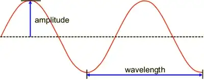

First, what you have to know is that a basic quantum wavefunction can be imagined as exactly just a sine wave:
A sine wave with 'amplitude' and 'wavelength' labels.
Second, you should know that the amplitude of the wave across an interval is related to the probability of measuring your particle's position within that interval. (This is an approximate analogy of what a probability density function does.)
Third, the wavelength of the wave is related to your particle's measured momentum. (If we want to be strict, it should be the frequency and it should also be a probability across an interval in frequency space, but it helps to imagine it with just a wavelength.)

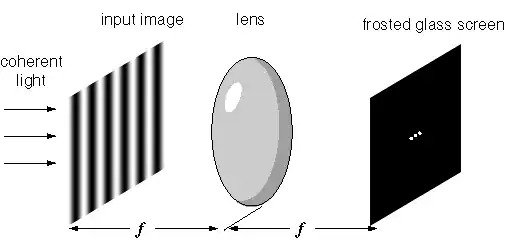

See Steven Lehar's web page for more. And note that the input image isn't some little dot. Nor is the lens. But when they interact, that's what you see, because you're seeing a real-time Fourier transform. It isn't just some abstract mathematical thing, and neither the photon or the electron is a dot.
