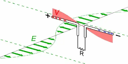

Here is an animation showing how a receiving antenna works.
In this animation you see a varying electric field coming in towards a pair of horizontal conductors (antenna).
Charges are moved in the conductor and this sets up a potential difference across the resistor which could be the input stage of a radio receiver.
A transmitting antenna works the same way except that an alternating voltage is applied where the resistor is and the alternating voltage causes the charges in the metal conductor to accelerate. Accelerating charges emit electromagnet radiation which in this case will be of the same frequency as that of the alternating voltage.

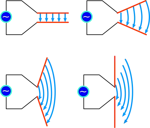

A dipole antenna is a capacitor which electrodes have been unfolded:
Dipole antenna as unfolded condenser
Dipole antenna as unfolded capacitor
The electric field is now stretched. In addition both sides of the dipole are inductors which create a magnetic field around them.
An antenna is an open circuit for DC (though there is an initial current flowing when the voltage is applied, until the capacitor is fully loaded), but is conductive when fed in AC (the feed impedance is actually 73Ω at resonant frequency).
As electrons going from one side to the other must all cross the center, there is more moving electrons near the center. Just before reversing the electrons direction, dipole extremities have a maximum opposite potential. So the well known distribution in the half wave dipole:
