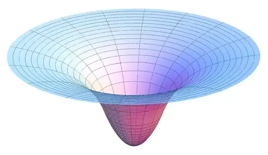

The Lagrange points exist in the space around two massive objects, say the Sun and the Earth. You can think of both of these as producing a gravitational potential well shaped a bit like a cone or funnel pointing down but with sides that make a curved profile. The gravitational potential as a function of distance $r$ is given by $U = -Gm/r$. Here's a nice picture grabbed from Wikipedea Gravitational Potential Well2. Image source: By AllenMcC. - Own work, CC BY-SA 3.0, Graviational Potential Well
Now, since there are two massive bodies there are two of these wells near each though the one centered on the more massive body will be bigger. You can imagine that there would be a saddle point between the two wells where the surface would be flat. This would represent a point where the forces of gravity pulling towards each body are in balance (I couldn't find a good image of two wells).

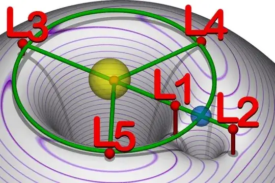

The thing is that the smaller body (say the Earth) is orbiting the larger body (Sun) or more accurately they are both orbiting their common barycentre. The Lagrange points are stationary as seen from the Earth so we need to consider things from a frame of reference that is rotating with the Earth. In such a rotating frame of reference we have to introduce a fictitious centrifugal force away from the centre of rotation. The addition of this force changes potential surface with the gravitational wells. Since the force is acting away from the centre an object near the centre would have a higher potential than one farther away so the potential for this force would look kind of like an inverted bowl. When you put together the effects of gravity from both bodies and the centrifugal force you get somewhat complicated effective potential surface. Here's an image, thanks once again to Wikipedia. Lagranian Points Equipotential
Image source: By User:cmglee - Own work, CC BY-SA 3.0,, Lagranian Points Equipotential
So, the five Lagrange points are places where the slope of this potential surface is zero. You could imagine yourself sitting there and not sliding away from them if you were careful. The $L_1$, $L_2$, $L_3$, are all saddle shaped whereas the $L_4$ and $L_5$ points occur at local maxima. They are like hilltops but quite flat hilltops.

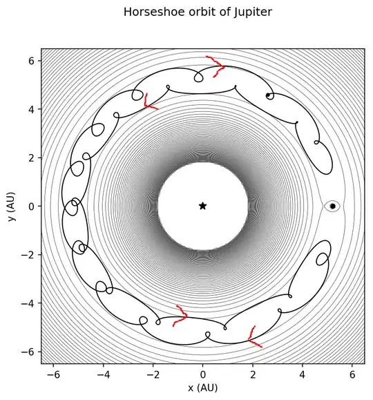

    $\uparrow $ Fig. 1: A possible horseshoe orbit along equipotential lines.

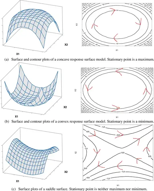

The above description provides some inside into why local minimums and (sometimes) local maximums are stable, while saddle points are always unstable. If the test particle tends to drift along equipotential lines, then near local minimums and maximums, it ends up in small concentric loops, while equipotential lines always point away from saddle points.
$\uparrow $ Fig. 2: A test particle tends to drift along equipotential lines due to the Coriolis force.
