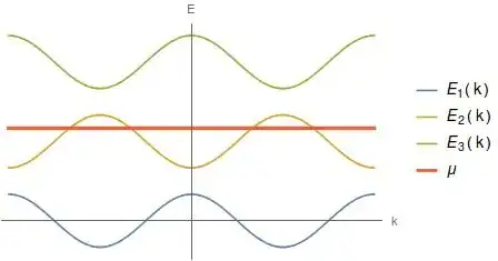

Everything you say is correct. The Fermi surface is defined to be the set of points $k$ such that $E_n(k) = \mu$ for any band $n$. However, typically the bands are spaced relatively far apart and don't overlap in energy, like this:
As we can see, the bands 1 and 3 lie completely above or completely below the chemical potential $\mu$ and so are irrelevant for determining the Fermi surface (in fact, at low temperatures, those bands are pretty much irrelevant for any physical phenomena - only bands near the chemical potential are physically important). That's why in practice, you can get away with just considering one or two bands and completely ignoring all the others - and when there's a Fermi surface (i.e. the chemical potential intersects a band(s)), one band is almost always enough.
In more complicated/unusual systems though, you do need to keep track of multiple bands. For example, sometimes bands can touch or cross, and funny things can happen if you tune the chemical potential exactly to the crossing point. Even more unusually, two bands can share a whole finite range of energy - e.g. two cosine curves shifted vertically by a tiny amount. But these cases are very rare - for most everyday materials, $\mu$ sits in at most one band and you don't need to worry about this. (In fact, professional physicists like to find/create unusual materials where the chemical potential does sit right at a band crossing, precisely because such systems aren't as theoretically well-understood, so there's more to learn.)
