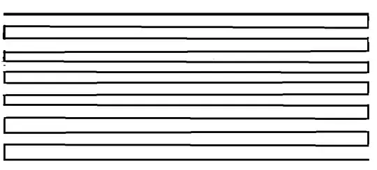

"A man is going to rub the chalk off a blackboard, he is going to choose a way to rub off the chalk in two ways
  1. Starting from the upper left corner of the board and moving horizontally to the right and moving slightly down and then again moving to the right and then when it reaches the left corner and so onenter image description here

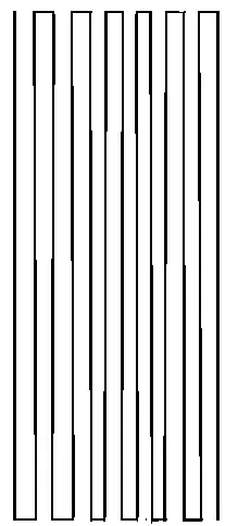

  2. The second way is given in the following: He starts at the top and rubs down and then up again and so on.

Somehow from vague intuitive notion I am inclined to agree that it would be less tiring to rub off the chalk if he moves the duster beginning at the top and rubbing horizontally and gradually decreasing the height when one reach the corners till everything is off.

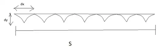

In the above diagram, we move by horizontally with a velocity $v$ to the right. But due to gravity the hand falls a distance $dy$ as we move $dx$.
Therefore the time it takes to fall by a distance $dy$ is given by $dt=\frac{dx}{v}$.
If $dx=\frac{S}{n}$ as $n\to \infty$, then from the laws of motion
$dy=\frac{1}{2}g\frac{(dx)^2}{v^2}$
Therefore for the whole journey from left to right our muscle has to give a beat up at an amount equal to the gravity force. So, the work supplied by the muscle for one trip would be
$$\int mgdy=\int_{0}^S mg \frac{1}{2}g\frac{(dx)^2}{v^2}$$

In the 2nd scenario work is done by the man when going up the board and work is done on the man when going down the board. If his arm acted like a spring the energy gained when going down could be used to go back up again. If he starts at the top and finishes at the bottom he gains the same net amount of energy as in the 1st scenario.
However, muscles do not act like springs : they do not store energy. They use energy going up; they also use a small amount of energy coming down, to slow the arm and prevent it from "free falling" and crashing into something.
