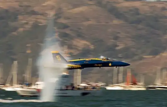

Yep, as you can see in the below image of an F-18 from the Blue Angels, breaking the speed of sound results in a sharp density gradient.
F-18 breaking sound barrier
You can see above the tail rudder the places where the index of refraction has changed due to the strong density gradient caused by a density wave driven by the change in the cross-sectional area of the jet (here causing a weak shock). The condensation cone only occurs as the piston transitions from subsonic to supersonic, i.e., during shock initiation due to the rapid change in pressure.

I am fairly confident that the picture was taken in the San Francisco bay area which is interesting since it is illegal to break the sound barrier over populated areas (I think "over land" is the legal phrase used but someone correct me if that is incorrect). The resulting sonic boom would have been rather loud, especially for anyone on the boats in the background.
I do not recall from where I found this image, as it was several years ago (see 2nd update below).

A colleague of mine informed me that the above photo was taken near San Diego, not San Francisco.
Update 2:
I will correct my first update in that the above photo was taken by Bernard Zee in the San Francisco bay.
