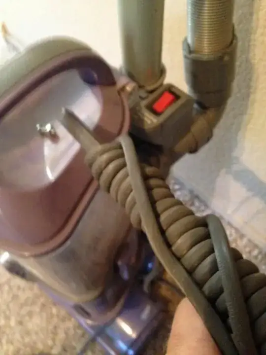

Okay, accuse me of having too much time on my hands, but here's what I did:
If you can't tell from the pic. I wrapped the vacuum cord around a steel bar. I turned on the vacuum and tried to pick up the screw. Absolutely nothing not even a hint of attraction so maybe BowlofRed has a point.
In case the comment gets deleted later, here is BowlofRed's comment:
The power cord has two conductors in it. The current is moving in opposite directions in each, so the net current flow through the cord is zero. No net current, no bulk magnetic field. – BowlOfRed
