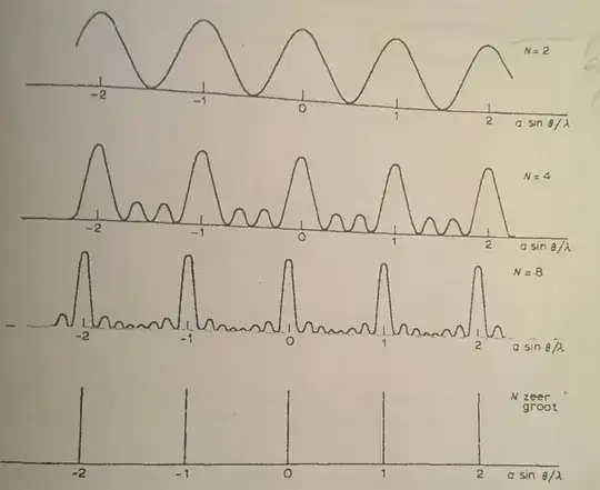

My question is related to young's theorem and the double slit experiment.
The more light sources we add the sharper the peaks of the interference pattern become. However when we add more light sources, more energy is being radiated. So my question is if the peaks become sharper where does all this extra energy go?
(respectively for 2, 4, 8 and many equal brightness, and evenly spaced coherent, light sources)

The first thing to note is that your diagrams are not to scale on the vertical (intensity) axis.
If the intensity of the peaks for the two slit pattern is $I_2$ then the intensity of the principal maxima for four slits is $\frac {4^2}{4}I_2 = 4I_2$, for eight slits $\frac {8^2}{4}I_2 = 32I_2$, for $N$ slits $\frac {N^2}{4}I_2$ and if $N=10^4$ the intensity of the principal maxima is $\frac {{10^4}^2}{4}I_2 = 2.5 \times 10^7I_2$.
So this perhaps gives you an indication of the energy flow being channelled into narrower and narrower corridors as the number of slits increases.
If one did the average from one principal maximum to the next one would find it to be $NI$ where $N$ is the number of slits and $I$ the intensity from one slit.

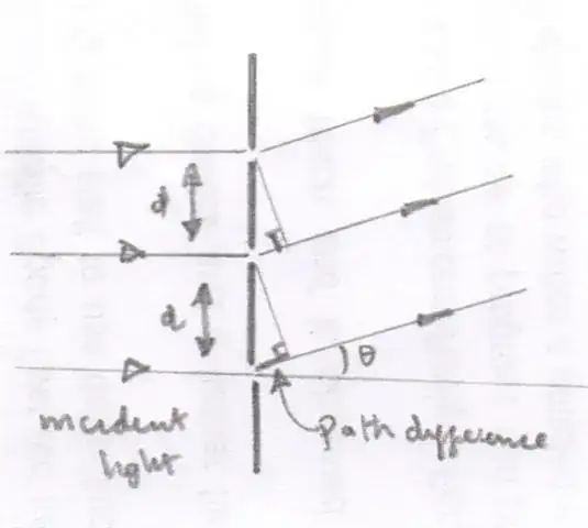

With multiple slits you are adding waves which emanate from the slits which differ in phase because they travel different distance.
The path difference is $d \sin \theta$ and so the phase difference between the waves $\phi = \dfrac {2 \pi d \sin \theta}{\lambda}$

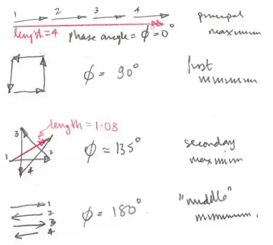

For your four slits the phasor diagrams at the maxima and minima look like this:
You will note that the principal maximum has an amplitude of $4A$ and hence an intensity of $16I$ where $I$ is the intensity from one slit.
The secondary maximum has an amplitude of just over $A$ and hence an intensity slightly greater than that of a single slit $I$.

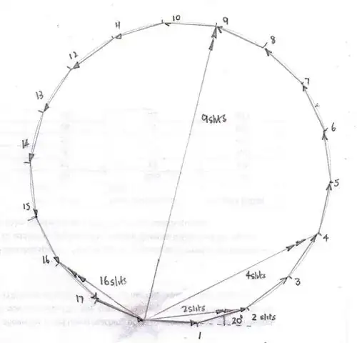

To illustrate the reason for the principal maxima becoming narrower as the number of slits increases consider the following phasor diagram where the phase difference between adjacent slits is $20 ^\circ$.
If you have 2 slits then there are only two phasors with a resultant length of $1.97$ and hence the intensity of the light at this phase angle as compared with the intensity at a maximum is $\dfrac {1.97^2}{2^2} = 0.97$, ie the intensity has hardly dropped at all.
With four slits the length of the resultant phasor is $3.70$ and so the intensity, relative to a principal maximum has dropped $\dfrac {3.70^2}{4^2} = 0.86$ which is more than for two slits.
Doing the same for nine slits $\dfrac {5.76^2}{9^2} = 0.41$ and sixteen slits $\dfrac {1.97^2}{16^2} = 0.15$ shows that by 16 slits the intensity at a phase angle of $20^\circ$ is very small compared with the intensity of the principal maxima.
Finally for 18 slits the resultant is zero for this phase angle and so by $20^\circ$ the first minimum has been reached showing that the principal maxima are so much narrower and intense than for two slits.
