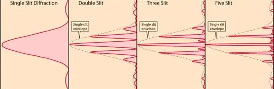

So here is the modulated interference pattern for one slit, two slits, three slits and five slits with all slits the same width and with the same slit separation.
Note the modulation of light intensity of the interference fringes by the diffraction envelope.

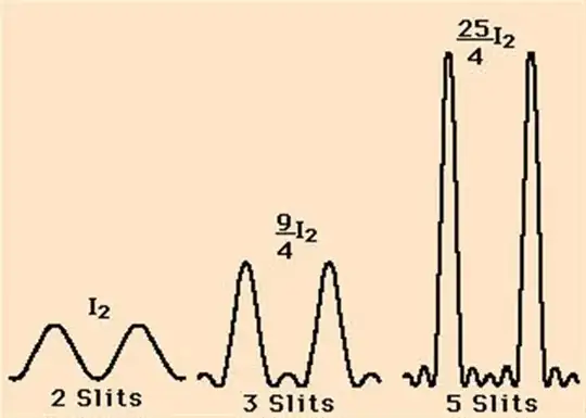

The other striking thing about the patterns for 2,3 and 5 slits is that the principal maxima get narrower as the number of slits increases and there are also in between the principal maxima much less intense subsidiary maxima.
What is shown by the next diagram is that as well as the principal maxima getting narrower they at the same time get brighter.
What is happening is that as the number of slits is increased the amount of light coming through the slits is increased and at the same time the light is being channelled into a smaller angular width (the fringe width).
Ignoring the diffraction envelope for 2 slits the intensity of a principal maximum $I_2 \propto (2A)^2$ where $A$ is the amplitude of a wave from a single slit.
For 3 slits $I_3 \propto (3A)^2$ and for five slits $I_5 \propto (5A)^2$.
So in a diffraction grating set up if the number of number of slits being used is reduced, say half the grating is covered up with black paper, the interference pattern would become less bright and the width of the principal maxima would increase.
Your three images are not comparing like for like.
For example the double slit pattern in the middle would appear to have slits which are much narrower than the slit used for the single slit pattern.
The reason for this inference is that the width of the diffraction envelope modulation of intensity is much broader in the second diagram than the first.
The last image of the pattern from a diffraction grating probably shows a much greater angular range than for the middle image because it shows the unequal spacing of the fringes.
It also shows that probably the width of the slits in the diffraction grating are much smaller than those in the two slit arrangement because there seems to be hardly any evidence of diffraction envelope modulation of intensity over a very wide angular range for the diffraction grating picture.

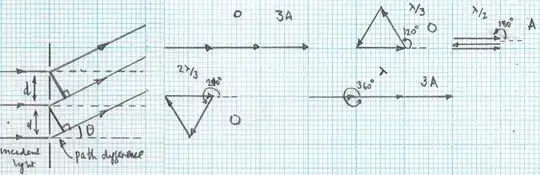

Although all the intensity graphs can be derived mathematically it is perhaps more informative to use phasor diagram to explain what is happening.
To make the analysis easier I have ignored the effect of the diffraction envelope.
For three slits you have the superposition of waves from three coherent sources each of amplitude $A$.
When $\theta = 0^\circ$ the three wave then the phase difference between the waves is zero and so when they overlap they produce a resulting amplitude for a principal maximum of $3A$. This is the $n=0$ fringe.
The same thing happens when the phase difference is $360^\circ$ which is a path difference of $\lambda$. This again results in a principal maximum of amplitude of $3A$. This is the $n = \pm 1$ fringe.

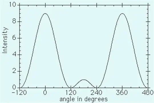

When the phase difference is $180^\circ$ which is a path difference of $\frac \lambda 2$, there is a secondary maximum of amplitude $A$.
For phase differences of $120^\circ$ and $240^\circ$ which correspond to path differences of $\frac {\lambda}{3}$ and $\frac {2\lambda}{3}$ the resultant amplitude is zero. There is a minimum in those positions.
So in the space between adjacent maxima for 2 slits there are now two minima and a secondary maximum. Thus the width of the principal maxima must have decreased.
