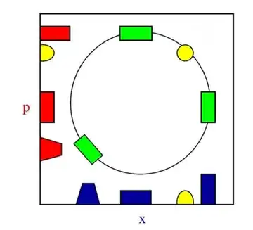

I am late in the discussion, and I've missed out on subtleties; but the way I might approach the problem would be through simple paradigms: well, the oscillator, is as classical as quantum systems go. With proper normalizations, the trajectory of every system for it is rigid rotation in phase space, both for any Wigner function (Groenewold, 1946) and its classical limit Liouville density: $f(x,p;t)=f(x\cos t-p\sin t,p\cos t+x\sin t;0)$ , enter image description here
A stationary quantum system is an axially symmetric Wigner function, and same for its classical Liouville density: What happens is that a stationary configuration is but the integral over all phases (call them starting times!) of any configuration. Since everything rotates in lockstep, the configuration appears (is) stationary, both quantum and classical mechanically.

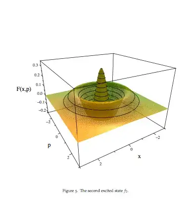

For instance, this is the 2nd excited state of the oscillator, at scales $O(\hbar)$, enter image description here
but there is nothing wrong with contemplating a huge (macroscopic) collective system in phase space ... of freshman lab size, which is axially symmetric, a thick swarm of noninteracting charged particles oscillating in a field in lockstep having started their oscillations uniformly at all moments of the oscillation cycle. (You did't say "realistic" now...)
The initial distribution may be picked to be positive semidefinite and axially symmetric: it need not be a pure star-eigenstate: It will rotate rigidly nonetheless and simulate a Liouville density.
But, in any case, this is the easiest way to illustrate the concept: Stationarity, at least for periodic motion, may well amount to a perfectly phase-smeared ensemble.
