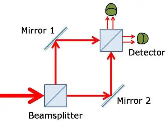

The argument uses a Mach-Zehnder interferometer:
It is explained that if a photon is introduced between the beam splitter and either of the mirrors, it will be detected at one of the two detectors at random. However, if it is introduced before the beam splitter, it will always appear at the same detector. From this follows that the (unobservable) split histories of the photon influence where it will be detected, so an explanation like splitting and interference of universes is necessary.
The question Deutsch doesn't answer is: Why does the photon always appear at the same detector?

Well, the quick and dirty answer is down to phase changes. In the upper path (re your diagram)to upper detector, the photon has bounced three times at a phase change of π each time. In the lower path the photon has bounced only once, hence a 2π difference and destructive interference. At the right hand detector, the upper photon bounces only twice as does the lower photon hence constructive interference. Whether or not this constitutes the full quantum explanation is still, maybe, open to debate.

I had the same question when I read about it in Penrose's The Road To Reality, but I found in https://arxiv.org/pdf/quant-ph/9610033.pdf that the apparatus must be carefully tuned to get the destructive interference.
Apparently, Mach-Zehnder interferometers are used in other applications where this is not the case.

The key, I think, is to understand that a beam-splitter represents a unitary process. If one writes down the unitary matrix that would represent the operation of the beam-splitter, one finds that the unitarity implies that there would always have to be a relative minus sign between the components of one output port compared to the other. As a result, if the paths give constructive interference for one output port, they will give destructive interference for the other. Hence, the photon only appears in one of the output ports.

The probability of a photon coming out of each port depends on the phase difference between the different versions of the photon at the final beamsplitter. For a mathematical description see Quantum Computation and Quantum Information by Nielsen and Chuang, Section 7.4 or this paper:
http://citeseerx.ist.psu.edu/viewdoc/download?doi=10.1.1.620.682&rep=rep1&type=pdf
