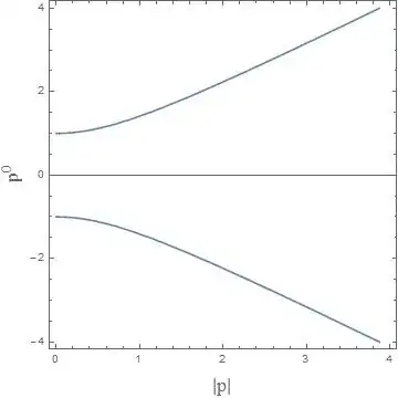

Sometimes, diagrams are more useful than equations!
Note that $p^2 = - (p^0)^2 + |\vec{p}|^2$ remains unchanged under any Lorentz transformation. Suppose that $p^2 < 0$ (say $p^2 = -1$). A plot of this hypersurface is shown below
Lorentz transformations that are connected to the identity are continuous transformations take a single point on this line to a different point on this line. Clearly, if I start off on the branch of the line with $p^0 > 0$, then no continuous transformation will ever take me to the $p^0 < 0$ branch. Thus, if $p^2 < 0$, Lorentz transformations cannot change the sign of $p^0$. Note that this is not true for the discrete Lorentz transformations such as $T$ which, of course, does change the sign of $p^0$.

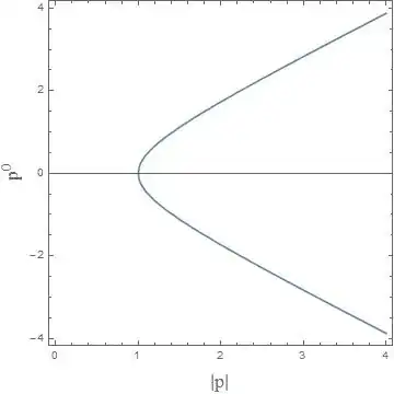

On the other hand, if $p^2 > 0$ (say $p^2 = 1$), then the hypersurface looks like
It is now possible to have a continuous Lorentz transformation that changes the sign of $p^0$.
