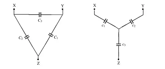

Perhaps the simplest method is to eliminate one of the nodes using the $Y$-$\Delta$ Transform. For a capacitor network it applies as follows (taken from section 5.7 of this document) :
capacitor Y-Delta transform
$\Delta \to Y$ use $c_1=C/C_1$ etc where $C=C_1C_2+C_2C_3+C_3C_1$.
$Y \to \Delta$ use $C_1=c_2c_3/c$ etc where $c=c_1+c_2+c_3$.

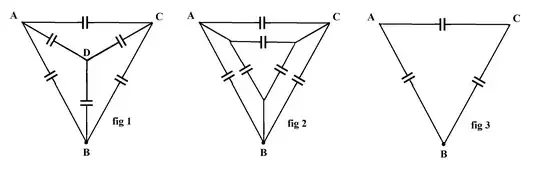

You can re-draw your network with ABC in an equilateral triangle with D at the centre (fig 1 below). D is connected to each of ABC, forming a $Y$ configuration with D at the centre. Using the transform this central $Y$ configuration can be converted into an equivalent $\Delta$ configuration, eliminating node D. Each of the edges AB, AC and BC then consists of 2 capacitors in parallel : the original capacitor, plus another from the $Y$-$\Delta$ transformation (fig 2). You should be able to simplify each edge AB, AC, BC into a single equivalent capacitance. Finally the network consists of only the triangle ABC (fig 3), ie edge AC in parallel with the series combination AB+BC.
