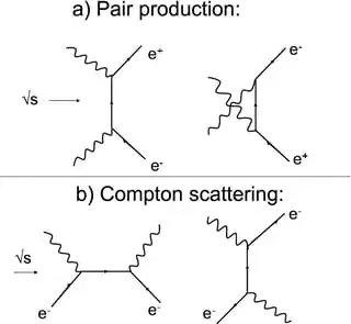

Compt
The incoming photon is real, i.e. on mass shell, 0 mass, energy $h\nu$. The vertex is a point and is the reason that particle physicists keep talking of point particles (until maybe string theory is validated, and we will then be talking of string particles). The concept of a photon as a particle is as realistic as the concept of an electron, and its existence is validated by the fit to the data of the standard model predictions.
So the answer is that the photon is a particle in the standard model of physics which fits the measurements in quantum mechanical dimensions, i.e. dimensions commensurate with $\hbar$.

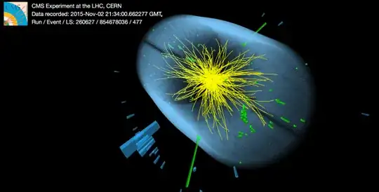

CMS diphoton even
This CMS diphoton event is in no doubt whether the footprint is a photon or not. It is a photon of the elementary particle table. It is only at the vertices of the interaction that the quantum mechanical indeterminacy is important.
