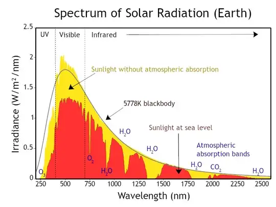

Here is the spectrum of the sun versus power.
sun
Take a specific frequency, divide the yellow power value with h*nu, h the planck constant nu the frequency , and you will find the number of photons at that frequency per meter square arriving on the earth before the atmosphere ( it will be a huge number because h is small). If you integrate over the yellow spectrum you will have the number of photons within the limits of the spectrum. The answer can be extrapolated to the sun, but it will give the number of photons within the limits of this spectrum.
At the location of the sun the infrared and below frequencies should also be added to the spectrum , and that can only be done with a specific model of the sun and its energy creation. This is a first estimated because the "atmosphere" of the sun which is plasma also radiates gamma rays which are missing in the spectrum arriving at earth.
With the planck constant of 6.626070040(81)×10^−34 the only real answer to how many photons is "very large".
