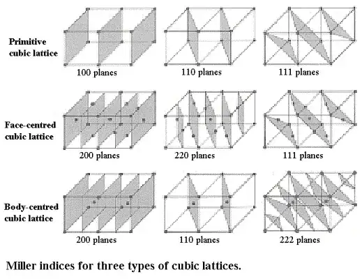

Could someone please explain what "adjacent" means in this case (Is it planes that share the same side, is it parallel planes, are these panes in the same unit cell or neighbouring cells etc)? Better yet, does anyone know of a sketch explaining this ? I am really at a loss here and this has been driving me nuts the whole day
valerio
  • 16,751
I could only find this poor-quality picture. It should give you an idea, anyway. For example, consider the first picture in the first row: $(l,m,n)=(1,0,0)$ in that case, and it is easy to verify that the distance between the grey planes is
$$d=a$$
In the second case, $(l,m,n)=(1,1,0)$, and you can see that
$$d=\frac a {\sqrt 2}$$
etc.
