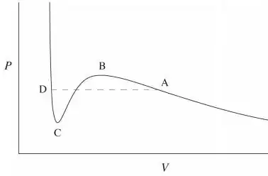

The "quantitative" rather than qualitative difference in a liquid-gas phase transition is due to the fact that the molecules arrangement does not change so much (there is no qualitative difference) but the value of the compressibility changes a lot (quantitative difference). This can be easily seen in the Van der Waals isotherms below the critical temperature,
The phase transition occurs at the dashed line $AD$. For volumes smaller than $V_D$, the high slope of the curve means that one needs a huge amount of pressure in order to decrease a small amount of volume. This characterizes a liquid phase which has a very low compressibility. For the slope is much lesser and the compressibility is high, which characterizes a gas. In between $V_D$ and $V_A$ there is a mixed phase characterizes by a divergent compressibility, i.e. the volume changes at constant pressure.

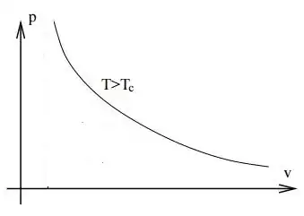

Above the critical temperature there is no longer such a radical change in the compressibility. The Van der Waals isotherm is the following
As you mentioned the density continually increase with the pressure. You can also see from the Van der Waals equation, when written as $$p=\frac{NkT}{V-Nb}-a\frac{N^2}{V^2},$$ that at very high temperatures it behaves like $$p\rightarrow \frac{NkT}{V-Nb},$$ which is not qualitatively different from an ideal gas isotherm. There is no liquid phase.

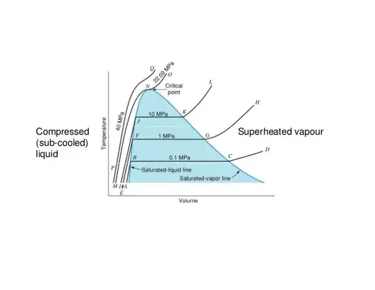

"Why the width of the two phase region is bigger at lower temperatures and pressures?" enter image description here Specific volume of liquids mostly depends on the temperature of them in comparing with their pressure. This means, for a well-defined increment of the pressure, we can neglect its effect on the specific volume of the liquid with respect to increment of the temperature of the liquid. So, by increasing the temperature, specific volume of the saturated liquid will increase.
On the other hand, specific volume of gases mostly depends on the pressure of them in comparing with their temperature. For a well-defined increment of the temperature, the influence of the pressure increment will be more much than temperature. So, by increasing the temperature, specific volume of the saturated vapor will decrease.
Thus, by increasing the temperature, the width of the two phase region will decrease and because of continuity of the properties of the substances, finally this width will be eliminated. I.e. a critical point certainly will exist.
