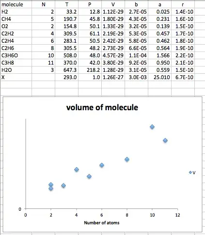

It is possible (as shown by @Diracology) to estimate the Van der Waals coefficients of the substance that would have the desired properties. Following those calculations (for which a derivation can be found here, I computed the Van der Waals coefficients $a$ and $b$ for a few small molecules. Plotting the volume (computed from critical parameters) against number of atoms in these molecules gives a "reasonable straight line". When I extrapolate that line (which is NOT a reasonable thing to do), I find that the X molecule would contain about 300 atoms:
(note - while I show pressure in atm in the table, I convert to Pa for the calculation).
As you can see - the hard thing is to get a molecule with such high intermolecular attraction (a=25; the most polar molecule in the list, acetone, has a=1.6 so you are about 15x off your target); but if you want to play with your computer model to create such a molecule, I think it could be fun.

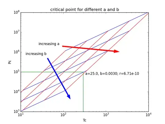

Just to help with the optimization, here is a graph showing the behavior of $a$ and $b$ and their effect of $T_c$ and $P_c$ (source code to generate this shown below).
And the source code:

a = np.logspace(-0.5,1.5,N1)
b = np.logspace(-4,-2,N2)
T = np.zeros((N1,N2))
P = np.zeros((N1,N2))
for ii in range(N2):
    for jj in range(N1):
        T[jj,ii]=tc(a[jj],b[ii])
        P[jj,ii]=pc(a[jj],b[ii])
Tc = 293
Pc = 1e5
plt.figure()
plt.loglog(T,P,'b')
plt.loglog(T.T,P.T,'r')
plt.loglog([Tc,Tc],[1e2,Pc],'g')
plt.loglog([1,Tc],[Pc,Pc],'g')
plt.xlabel('Tc')
plt.ylabel('Pc')
plt.title('critical point for different a and b')
plt.xlim((1e1,1e4))
plt.ylim((1e3,1e8))
bc = R*Tc/(8*Pc)
ac = 27*bc*bc*Pc
vc = bc/(4*Na)
rc = np.power(3*vc/(4*pi),1./3.)
t = '  a=%.1f, b=%.4f; r=%.2e'%(ac,bc,rc)
plt.annotate(t, xy=(Tc,Pc), verticalalignment='top')
plt.annotate('increasing b', xy=(0.4, 0.1), xycoords='axes fraction',
                xytext=(0.2, 0.6), textcoords='axes fraction',
                arrowprops=dict(facecolor='blue', edgecolor='none', shrink=0.05),
                horizontalalignment='right', verticalalignment='top',
plt.annotate('increasing a', xy=(0.8, 0.6), xycoords='axes fraction',
                xytext=(0.3, 0.7), textcoords='axes fraction',
                arrowprops=dict(facecolor='red', edgecolor='none', shrink=0.05),
plt.show()
