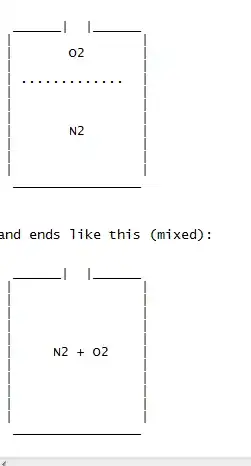

So my question is, if one added to 8 litres of nitrogen 2 litres of oxygen, how quickly would the mixture be thoroughly mixed? At least mixed enough that any measurement would be the same to within .1 % throughout the cylinder. (That's a tenth of one percent.)
So the cylinder starts like this (unmixed)
I have no idea how to calculate this.
