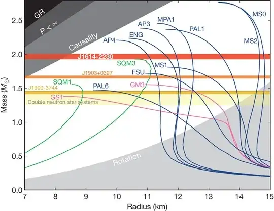

The picture below (from Demorest et al. 2010) shows the mass-radius relations for a wide variety of equations of state. The limits in the top-left of the diagram indicate the limits imposed by (most stringently) the speed of sound being the speed of light (labelled "causality" and which gives radii slightly larger than Shapiro & Teukolsky's approximate result) and then in the very top left, the border marked by "GR" coincides with the Schwarzschild radius. Real neutron stars become unstable where their mass-radius curves peak, so their radii are always significantly greater than $R_s$ at all masses and therefore significantly bigger than 5km for typical neutron stars.

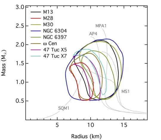

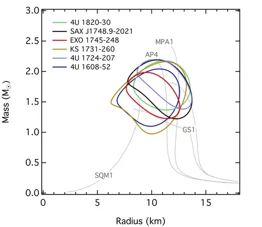

If the theoretical arguments don;t convince then we can look at the best, most recent observational evidence. Ozel et al. (2016) have performed a homogeneous analysis of the X-ray spectroscopy of neutron stars in low mass X-ray binaries: either those that are "bursting sources" or those that are in quiescence. Both cases can be analysed (using different spectral models) to yield both neutron star mass and radii. The constraints are summarised in the plots below. They show that neutron stars do have radii of around 10 km (10.1-11.2 km for neutron stars at $1.5M_{\odot}$).
Radii from bursting LMXBs (from Ozel et al. 2016). 68 percent confidence contours are shown
Radii from quiescent LMXBs (from Ozel et al. (2016). 68 percent confidence contours are shown.
