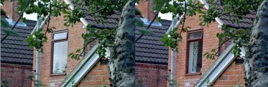

"Reflected light is polarized". The following photo demonstrates this:
enter image description here(source)
When unpolarized light is incident at this angle, the light that is reflected from the surface is therefore perfectly polarized (Wikipedia).

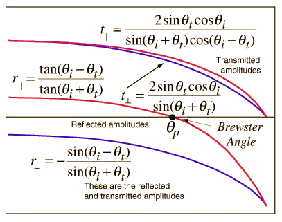

In your final two paragraphs you have it backwards. At Brewster's angle the reflected light is totally polarized, but the total polarization of the transmitted light is usually rather weak. Compare reflection coefficients $r$ and transmission coefficients $t$ from the Fresnel equations:
Reflected light is completely polarized at Brewster's angle because the direction of propagation $\vec S = \vec E \times \vec B$ is perpendicular to the electric field $\vec E$. A hand-wavy way to describe Brewster's angle is to observe that there, the angle between transmitted and reflected light is 90$^\circ$. Therefore your EM oscillations in the transmitted beam can't contribute evanescently to the reflected wave, except where $\vec E$ is parallel to the surface.
