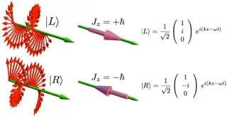

Photons in ensembles build up the classical electromagnetic wave which will have its coherence length . I have found this image of how polarization is built up by individual photons that just have +1 or -1 spin useful in getting an intuition of how the classical wave is built up.
spinangulmom
Left and right handed circular polarization, and their associate angular momenta. A QED explanation of how individual photons build up a classical wave can be found here.
