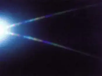

The reflection of a small light (but with enough power) on our TV shows four emerging rays. The rays vary periodically in space and have a repeating pattern of the colors of the rainbow. The further the flame is from the TV the greater the distance between the periodic lights in the "rays". Sounds reasonable. This is the picture of the effect:
No matter how far you put the candle, the angle between the two lines stays the same. The color green is very faint in the picture but was clearly visible on the TV screen. The distance between successive red/green spots was getting smaller if the distance between your eye and the screen was getting smaller. Sounds reasonable. No matter how the light was positioned relative to the TV, the same pattern emerged.

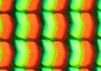

I added a close-up picture of the working TV on which you can see what form the light-emitting pixels have:
Notice that they are curved, or better said, consist out of two little rectangles with an angle between them that is, at first sight, the same as the angle between the light rays seen on the TV-screen. When I measured the angle of the rays on the TV-screen it was about the same as the angle between the "line"-pieces of the pixels (about 180-(2x16)=148 degrees). Maybe here lies the clue to the problem. What would be the pattern seen on the TV-screen if the pixels would be square, rectangular (with the length vertically), or round? Or formed and arranged like here:

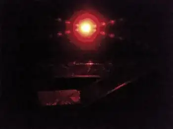

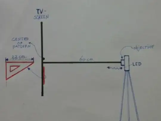

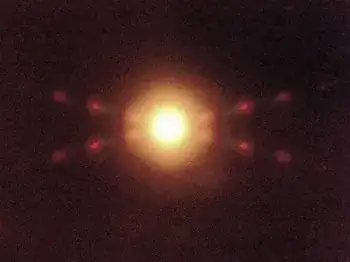

The fourth and fifth pictures I made by using a white and red LED (which shows the periodic Nature most clearly, and even red concentric rings), and in the sixth picture, I added some information on how I made the picture.

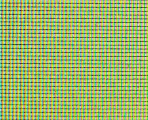

I added this close-up picture of my laptop screen:
It's not that good visible, but the pixels are rectangular shaped (in vertical position). They are much smaller than the pixels on my big TV-screen, which I almost can see with the naked eye (once you know the shape after taking the close-up picture, which can't be said of the pixels of my laptop's screen). The effect isn't visible on my (power off) laptop screen, maybe because of the smallness of the pixels. The effect is (as I said ) color-dependent (with a red beam of light only a red X-form, periodically bright and dark is seen) and orientation independent (no matter how I point the light beam the same X appears over and over again). Nevertheless, I don't know if the pixels on both screens are the same (though it appears so).

It looks like a diffraction pattern from the pixels of the screen. In a different SE question, the pattern was four horizontal and vertical "rays" consisting of finely spaced peaks, rather than the wide spacing here and the angles that differ from 90 degrees.
If you measure the apparent angle between the first diffraction peaks (the ones at the edge of the halo) and the central spot, you can relate that to the wavelength (say, 600 nm) and the dot pitch of the tv screen. The ratio of distances screen-eye versus screen-candle also matters; the analysis is easier if this ratio is much smaller than one.
Regarding the angle between the rays: I suspect that your screen does not have rectangular pixels, but pixels arranged in some kind of staggered arrangement. However, I can't guess the exact pixel arrangement from the diffraction pattern. It could also be that you took the photo from an angle. Maybe you could post a picture of the TV pixels in close-up (when the TV is on) and a sketch of the relative locations of camera, candle, screen, and apparent diffraction spots.
