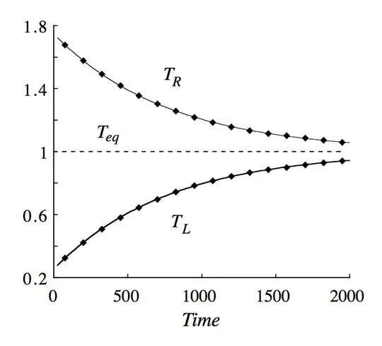

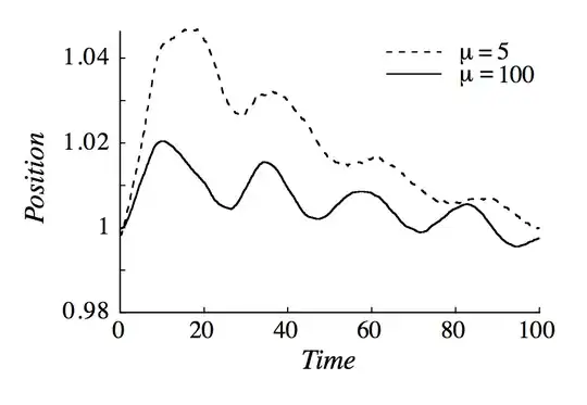

There have been also simulations of your problem which show that if we start with $P_1=P_2$ and $T_1\neq T_2$ the piston will oscillate until we reach thermodynamic equilibrium ($T_1=T_2$). See the pictures below, which I took from the article.
