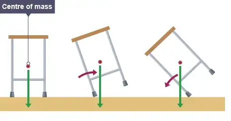

No your explanation is not missing anything.
Objects topple on inclined planes for the same reason they topple when pushed on horizontal planes.
If the object does not slide, the edge of the base will form a pivot about which the object can turn. Suppose the object is tilted gradually about this pivot then released. If the vertical line through the CG remains inside the base, then the weight forms a torque about this pivot which turns the object back onto its base. If this line falls outside the base, the torque due the the object's weight continues to turn the object away from its base.
Source : BBC Bitesize Physics website
If the object does slide, accelerating down the incline, then the situation is more complex. See BowlOfRed's answer to What causes a tall box to tip over on an inclined plane?
