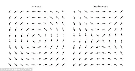

The resolution is then obtained by noting that in forgetting the angular nature of $\theta(x)$, the continuum gaussian "spin wave" theory does not account for windings of the angular phase field from $0$ to $2\pi$. These are called vortices (and anti-vortices), and they correspond to topological defects in the $\theta(x)$ field (which is then not defined at the core of the defect). They are perfectly reasonable configurations on the lattice whose continuum limit corresponds to point singularities in the angle field. enter image description here Note that these configurations never appear in a perturbative gradient expansion and are hence non-perturbative in nature. At the continuum level, the vortex is a singular solution of the euler-lagrange equation. $$ \nabla^2\theta=0\\ \oint_{\Gamma}\mathrm{d}s\cdot\nabla\theta=2\pi q $$ where $\Gamma$ is closed loop encircling the origin and $q$ is the integer "charge" of the vortex. This basically says that as you go once around the origin, the phase field $\theta$ goes from $0$ to $2\pi q$ (which is the same as $0$ for a periodic function as $q$ is an integer). Now for a single such defect, we have $|\nabla\theta|=q/r$ ($r$ being the radial coordinate), we can compute its energy to be, $$ E_q=\pi J q^2\ln\left(\dfrac{L}{a}\right) $$ which diverges logarithmically in the thermodynamic limit. Hence single defects are never excited, but defect pairs with opposite charges (dipoles) have a finite energy and can be excited at finite temperature. Neglecting interactions for the time being, there is a very simple hand waving argument for the existence of a phase transition. The energy of a single free defect diverges, but at finite $T$ one must look at the free energy which includes entropic contributions too. The number of ways a single defect of size $\sim a^2$ can be placed in a area of $L^2$ is roughly $(L/a)^2$. taking the logarithm to get the entropy, we have for the free energy $$ F=E_q-TS=(\pi J q^2-2 k_B T)\ln\left(\dfrac{L}{a}\right) $$ As the lowest charge excitations correspond to $q=1$, we have for $T>T_c=\pi J/(2 k_B)$, the free energy becomes negative, which means that there is a proliferation of free defects in the system as entropy wins over the defect energetics. Including defect interactions doesn't change this picture (even $T_c$ remains the same). At $T=T_c$, one obtains a universal power law decay (upto log corrections) $$ \langle\vec{S}(x)\cdot\vec{S}(0)\rangle=\left(\dfrac{x}{a}\right)^{-\eta} $$ with $\eta(T_c)=1/4$. Above $T_c$, we have a finite correlation length ($\langle\vec{S}(x)\cdot\vec{S}(0)\rangle\sim e^{-x/\xi}$), which diverges exponentially fast as one approaches the transition form above.

What is missing in the spin-wave analysis is the possibility of vortices, that is, the possibility that, as one goes along a closed loop on the lattice, the angles of the spins on the lattice sites visited add to multiples of $2\pi$, see picture. enter image description here
These vortices are high energy spin excitations, but they turn up to be very important to understand the transition from long-range correlation at low temperature, and short-range correlations at high temperature. Furthermore, they are said to be topological excitations because one cannot undo a vortex by locally changing the orientation of spins (that is, if you just decide to turn a spin by some angle, the vortex will still be there). The only way to destroy vortices, is to annihilate a vortex with an antivortex (a vortex that turns in the opposite direction). Their creation goes also by pairs.
We know have all the ingredients. At low temperature, there is very few vortex-antivortex pairs, as they cost a lot of energy to create, and they tend to stay very close together (they are bounded). Much like an electric dipole is just neutral when seen from far, these bounded pairs do not affect to much the correlations at long distance, and those are still long-range.
However, as the temperature rises, more and more pairs are created, and the distance between the vortices and antivortices grow further and further apart, until there is an unbiding transition : all the vortices and antivortices are free to move, which destroys the correlations between too distant spins.
