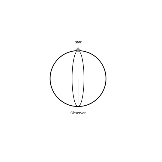

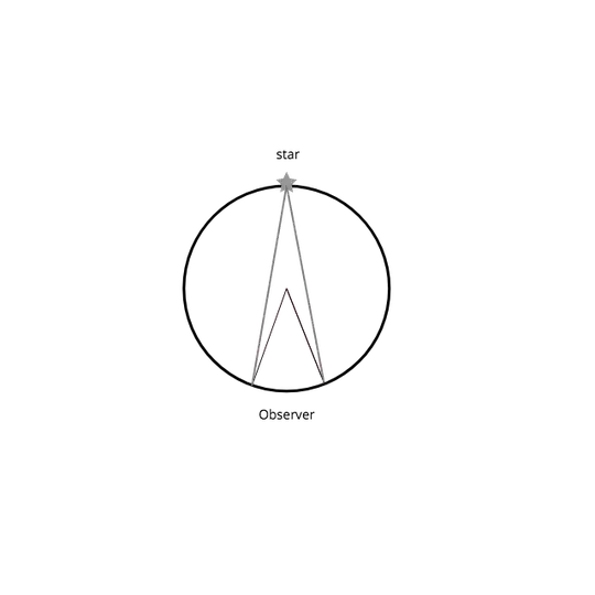

Physically, imagine the following setting: ligth_bending i.e. the string is in between a star and an observer. The metric (3) tells us that the spacetime is flat with a wedge missing, hence in this chart, the light rays move on straight lines. However, we need to identify the sides of the missing wedge, and hence we see that in fact the light rays bend enter image description here
