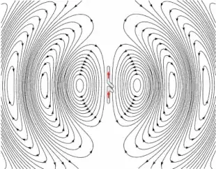

A vertical rod, a usual dipole, produces radio waves in the horizontal plane, mostly in two opposite directions:
$\qquad \qquad \qquad \qquad \qquad $antenna
If that is possible, how do you produce a spherical EM radiation? should the antenna be a (..n expanding and contracting) globe or a circle? How should the charges oscillate? and, lastly, would its energy decrease by 1/$4 \pi r^2$ and so its range would be rather short?
