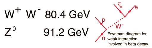

feynmdiag
The neutron and the proton are of order of GeV, they are real particles with their on shell masses in the calculations. The same is true for the outgoing antineutrino and electron. The W- is virtual, very much off shell, that's why the neutron does not decay immediately, as the on shell mass of the W is in the denominator of the propagator in the integral and together with the weak coupling constant the decay of a free neutron takes minutes.
Where does the HUP enter in this diagram?
If we take delta(t) the 16 minutes of the lifetime it tells us that multiplied with delta(e) the energy of the interaction, order of 2GeV, multiplied should be larger than h_bar/2 . This is of course fulfilled as h_bar is such a small number.

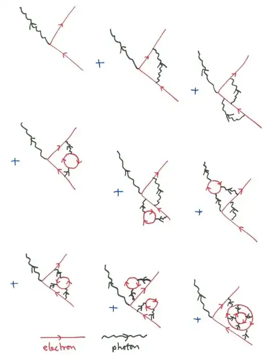

Now by themselves, virtual particle loops have no meaning , because there are no input and output legs entering the diagram. Loops exist in higher order perturbative expansion calculations of real diagrams, the red circle:

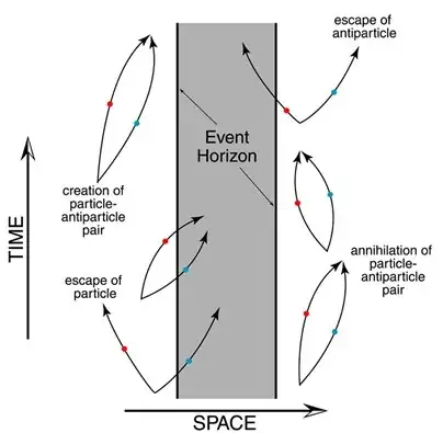

As far as Hawking radiation goes, the logic is that : for a real particle to come out an interaction line of a virtual particle with the fields of the horizon has to have taken place, the energy necessary for reality picked up from the field of the black hole.
Here is a diagram ( not a feynman one) of the picture of hawking radiation from vacuum fluctuations next to the horizon.
vacuum fluctuations
It is not a feynman diagram, because it does not have the interaction vertex with a field at the horizon which will provide the energy for the particle to become real and the absorption of the second one by the black hole. But it is on the lines that due to the HUP a locus in energy and time exists which is not measurable but can be described by virtual loops of the type existing in higher order diagrams.
