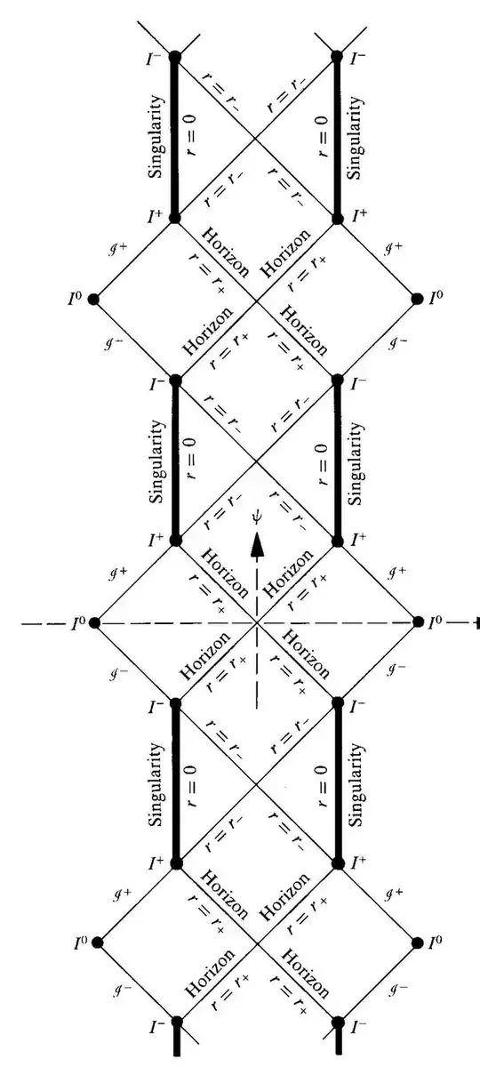

Here's an example of a black hole that is technically inside another black hole: the maximally extended Reissner-Nordstrom solution. In this case, what we mean by being "inside" the black hole is that the event horizon for one black hole is completely to the future of the other (see below for why this isn't intuitively what you would think of as one black hole inside of another). This solution corresponds to a spherically symmetric spacetime with electric charge in the center of spherical symmetry. The Penrose diagram for this solution is shown here:
Penrose diagram of a Reissner-Nordstrom Black Hole
Starting at the horizontal dashed line and moving upward, we encounter the first black hole event horizon at the diagonal line labeled $r=r_+$. Passing this, we enter the first black hole, and unlike the Schwarzschild solution, there are now two separated timelike singularities at $r=0$. Because they are timelike, they can be avoided, so a timelike worldline can begin moving radially outward once it passes the first surface labeled $r=r_-$. Eventually this line will emerge out of a white hole horizon (at the next set of lines labeled $r=r_+$, and then will see there is another black hole horizon to the future. The maximally extended solution in fact consists of an infinite chain of black holes and white holes, and each is inside the next in the sense that each successive black hole is to the future of the previous one. Such a black hole chain also arises in the maximally extended Kerr black hole, describing a cylindrically symmetric spinning black hole in vacuum.
Of course, this spacetime is somewhat exotic. It possesses Cauchy horizons, for example at the first $r=r_-$ surface, so that initial data on the first slice does not completely determine how fields will evolve throughout the space time (you need extra boundary conditions at the singularity). Cauchy horizons are generically thought to be unstable, so it is unlikely such a black hole chain would ever arise in an astrophysical black hole. Perturbations to this spacetime tend to cause the chain to pinch off, leading to null or spacelike singularities.
You could probably cook up other examples of black holes with multiple asymptotic null infinity regions which has one black hole inside the other. It is likely that for such an exotic situation you end up violating an energy condition for the spacetime, or having other pathologies such as not being globally hyperbolic. In fact it might be possible to prove various theorems about global hyperbolicity or other aspects of the causal structure in these cases, although I don't know of any work examining this in detail.
