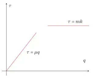

  • In the widely used Coulomb's friction law $F=\mu n$, the coefficient of friction $\mu$ is a constant and $n$ the normal force. The law was originally defined in a general per-area form: $$\tau=\mu q$$ where $\tau$ is friction per area and $q$ is normal pressure (normal force $n$ per area). This law only applies at low normal pressures - that is, when the normal pressure $q$ is way lower than the shear strength $k$ of the weakest material. In this case, when pressing the surfaces harder together, the asperity tops will be more flat. This will increase the real contact area proportionaly to the pressure, which is what this law shows.
The shear strength $k$ tells something about when a material will start to deform from such sideways motion. Such deformation will namely change the surface and thereby the roughness and contact area.
  • At higher normal pressures, one may use a constant-friction model: $$\tau=mk$$ The coefficient $m$ will be in the range from $0$ to $1$. This illustrates how we at high pressures have flattened the asperities fully. Further pressure therefore can't flatten them more, and the contact area is constant at higher pressure. Therefore friction remains constant for higher pressure, as the law states, and now only depends on the materials strength $k$.
The combination of these two models is called the Orowan's friction model, where the first one will apply for $\mu q \ll k$ and the second for $\mu q \gg k$. In the range around $\mu q = k$, this model is not usable. This is namely the region where the deformation zones around the asperities, which are being flattened, start to meet and overlap. The deformation zones Thus prevent each other from deforming further, and therefore the contact area stops being proportional to the increasing pressure. When the asperities are fully flattened the constant-friction law takes over. See the graph below:
The in-between transition region is much more complicated than any of the two laws, which are merely applied in their respective regions in order to have simpler expressions to work with. Other models are trying to model the whole friction range better. The only one I know of is the Wanheim and Bay's friction model, which takes into account the area dependence:
