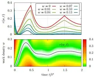

At present, a widely accepted one is by Heyl et al. See their original paper Dynamical Quantum Phase Transitions in the Transverse Field Ising Model. Basically, it means some quantity (e.g., the fidelity) as a function of time is non-analytical at some critical times. See the cusps in the following figure:

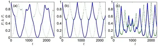

Similar evolution behavior was also discovered in single-particle systems, like the one dimensional tight binding model (see Cusps in the quenched dynamics of a Bloch state and wherein for other models). The cusps are sharp too:
Here each segment is a parabola.
