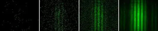

Photons are elementary particles obeying quantum mechanical rules, and the simple experiment of single photons scattering off double slits shows that same energy photons one at a time have different trajectories, and it is only the ensemble that shows the wave nature of the interaction.
sinlgle phot
Single-photon camera recording of photons from a double slit illuminated by very weak laser light. Left to right: single frame, superposition of 200, 1’000, and 500’000 frames.
For this experiment, for each point hit of a photon a trajectory can be drawn with the uncertainty of the double slit width. A very narrow wavepacket in space.
