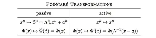

See for instance these notes on QFT on manifolds, particularly the following table after Eq.(8):
