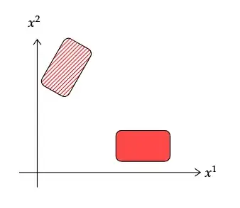

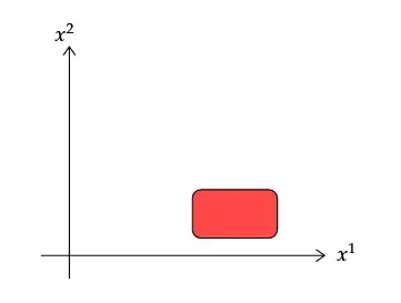

Consider the following picture.
We have a field which is large in the red rectangle and small elsewhere. The function which tells us the field value at some point at coordinates $\mathbf x$ is $\phi$; that is, $\phi(\mathbf x)$ is the value of the field at the point labeled by coordinates $\mathbf x=(x^1,x^2)$.
Now we perform an active transformation corresponding to a rotation of the field by $60^\circ$.
We're using the same coordinates, but after the transformation $\phi$ is no longer the function which gives us the field values. We must consider a new function $\psi$ which is related to the old one via
$$\psi(\mathbf x) = \phi(R^{-1}\mathbf x)$$
where $R$ is the $60^\circ$ rotation matrix.

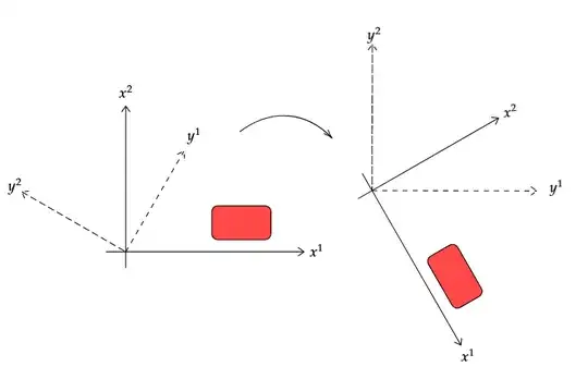

Now we consider a passive transformation instead.
This is a change of coordinates where the new coordinates $\mathbf y = (y^1,y^2)$ are related to the old ones via
$$\mathbf y = R\mathbf x$$
Once we've adopted the $y$-coordinate system, $\phi$ is once again the wrong function. The field values at a point $\mathbf y$ are given by the function $\sigma$, which is related to $\phi$ via
$$\sigma(\mathbf y) = \phi(R\mathbf y)$$
Use the pictures to convince yourself that if $\phi$ is large at, say, $\mathbf x=(1,0)$, then $\sigma$ will be large at $\mathbf y = \big(\frac{1}{2},-\frac{\sqrt{3}}{2}\big)$. In other words, $\sigma\big(\frac{1}{2},-\frac{\sqrt{3}}{2}\big) = \phi(1,0)$, which is consistent with $\sigma(\mathbf y) = \phi(R\mathbf y)$.

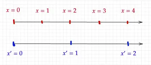

Again, this is wrong. Perhaps it would be simpler to consider a single coordinate $x$ and a scaled coordinate $x'=2x$.
When we say $x'=2x$, we do not mean that the new label of a point is twice the old label. Instead, we mean that the $x'$ "tick marks" are twice as far apart as the $x$ tick marks are.
What this means is that the $x'$ coordinate of a point is half the corresponding $x$ coordinate of that point. As you can see on the diagram, $x=3$ corresponds to $x'=1.5$, not $x'=6$.
Ultimately, you're making the same error as if you said "1 meter is equal to 100 centimeters, so the position of a point in meters is 100$\times$ the position of the point in centimeters". You have it backwards.
