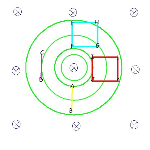

Let's choose a simple solution and analyse it. I'm taking the case where the coexisting electric field is just concentric circles.
In this diagram, the blue stuff is the $\bf B$ field, and the green stuff is the $\bf E$ field. Being lazy, I haven't added arrows to it (I also haven't spaced the circles properly. There should be more space between the inner ones and less space between the outer ones). The other things are just rods and wire loops.
To avoid confusion, when I refer to "emf", I mean "the energy gained/lost in moving a unit test charge along a given path". Mathematically, the path integral $\int_{path}\mathbf{E}\cdot \mathrm{d} \vec l$. I'll come to voltmeters and the like later.
Let's first look at the rods. The yellow rod $AB$ will have no emf across its ends, since the $\bf E$ field is perpendicular to its length at all points. On the other hand, the magenta rod $CD$ has an emf across its ends. This emf can be easily calculated via some tricks--avoiding integration--but let's not get into that right now.
You now can probably see why the second point "Where is the rod in relation to this electric field?" matters.
On the other hand, this second point is not necessary for a loop. Indeed, neither is the first point.
Going around the loop, both loops (cyan and red in diagram) will have an emf $-A\frac{\partial\mathbf{B}}{\partial t}$. It's an interesting exercise to try and verify this without resorting to Faraday's law--take an electric field $\mathbf{E}=kr\hat\tau$ and do $\int \mathbf{E}\cdot\mathrm{d}\vec l$ around different loops of the same area. You should get the same answer.
But, you cannot divide this emf by four and say that each constituent "rod" of the loop has that emf. For example, in the cyan loop $EFGH$, $EF$ has no emf, and the rest have different emfs. "dividing by four" only works (in this case) if the loop is centered at the origin.

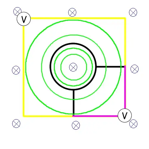

Voltmeters
Voltmeters are an entirely different matter here. The issue with voltmeters is that, even for so-called "ideal" voltmeters, the p.d. measured depends upon the orientation of the voltmeter.
Reusing the same situation:
Here, the black wires are part of the current loop (and peripherals). The yellow/magenta wires are to be swapped in and out for using the voltmeters. Only one set of colored wires will be present at a given time.
Here, the "yellow" voltmeter will measure a pd three times that of the "magenta" one. This is due to the fact that it spans thrice the area and consequently has thrice the flux.
Remember, induced $\bf E$ fields are nonconservative, so voltmeters complicate things. They don't really tell you anything tangible, either.
If the voltmeter were an everyday, non-ideal galvanometer based voltmeter, there would be extra complications due to there being a second loop.
