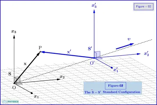

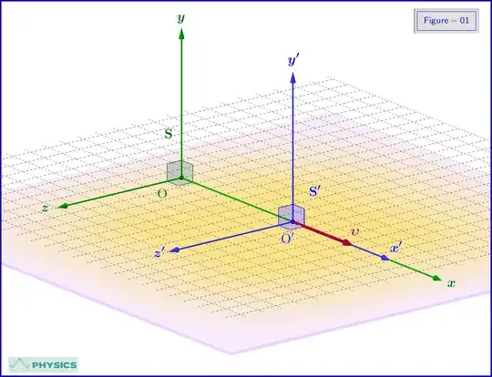

In Special Relativity we couldn't say in general that the axes of two inertial frames S and S′ in relative translational motion (boost) are parallel, see Figure-02, except of special cases, see Figure-01.
In case of a general boost with velocity $\:\boldsymbol\upsilon$, see Figure-02, we could not talk about parallel axes. For example, the points of the $\:x'_2-$axis in frame $\:\rm S'\:$ at a given moment $\:t'\:$ are simultaneous events in Minkowski space, so the $\:x'_2-$axis is a well-defined straight line in $\:\rm S'$. But these events are not simultaneous in $\:\rm S\:$ so there doesn't exist such a thing or curve or whatever else in $\:\rm S\:$ to be parallel to the $\:x_2-$axis.
Reference : My answer here How to represent a pair of inertial frames in relativity?.
