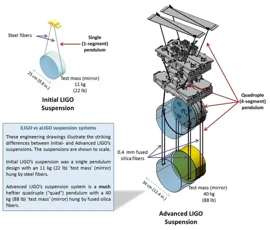

How does LIGO remove these factors, and take precautions to prevent false readings due to noise?
13
This is indeed a problem, which is dealt with using seismic isolation via Internal Seismic Isolation and Hydraulic External Pre-Isolators. The original LIGO isolation systems were passive - described here as shock absorbers - and included a single pendulum system, but the Advanced LIGO (aLIGO) upgrades added actuators that counteract vibrations in various components, as well as a quadruple pendulum system:
